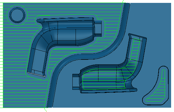

For example:
Select Fixed direction
Enter an Angle of 0

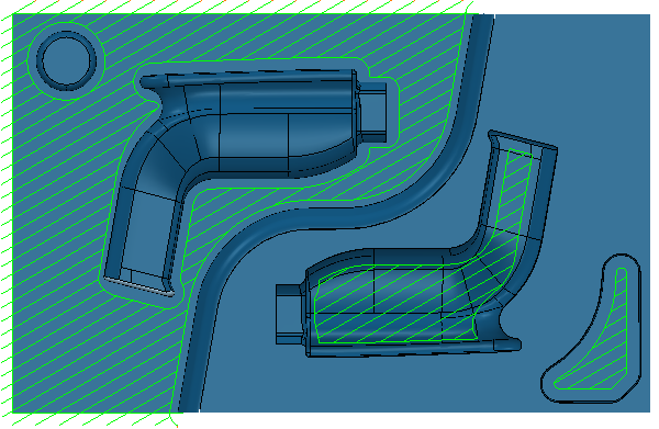

Enter an Angle of 30

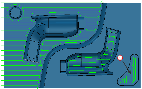

Deselect Fixed direction
In this case, most of the toolpath has an Angle of 0, but pocket has an Angle of 90.
