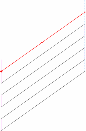

Cut Direction — Select whether or not the toolpath changes direction between axial steps.
Uni-Directional — Select this option so that after the tool completes a pass of the toolpath in one direction, the next pass in depth is in the same direction.
Bi-Directional — Select this option so that after the tool completes a pass of the toolpath in one direction, the next pass in depth is in the reverse direction. This minimizes tool lift and travel.
Note: The Cut Direction option is available only if the Tool Position is set to On.

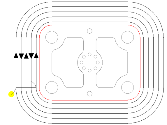

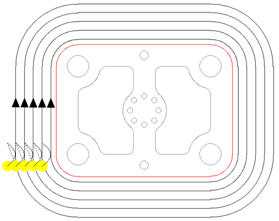

Toolpath Direction — Select whether or not the toolpath changes direction between radial steps:
Uni-Directional — Select this option so after the tool completes a pass of the toolpath in one direction, the next pass over is in the same direction.
Bi-Directional — Select this option so after the tool completes a pass of the toolpath in one direction, the next pass over is in the reverse direction. This minimizes tool lift and travel.
Note: The Toolpath Direction option is applicable only to roughing and is available only if the Tool Position is set to Left or Right. You should also ensure that the Initial Stock value is greater than 0.
