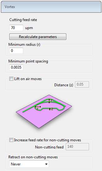

Use the Vortex page to create toolpaths that machine at the specified cutting feed rate almost all of the time.
Cutting feed rate — By default, PartMaker uses the feed rate specified in the Cutting feed rate field in the Vortex page of the Advanced 2D Milling Defaults dialog. However, you can enter a different value, if required.

Recalculate parameters
PartMaker uses the feed rate to calculate the Minimum radius and Minimum point spacing values for a Vortex toolpath. Therefore, you should click Recalculate parameters if you change the feed rate so that PartMaker recalculates the Minimum radius and Minimum point spacing values based on the new feed rate.
Note: PartMaker normally calculates the feed rate for a process when generating the Process Table. However, for Vortex toolpaths PartMaker uses the value specified on the Vortex page. You can change the feed rate value used for a particular process using the Process Parameters dialog.
Minimum radius (r) — This is the minimum radius used in the internal trochoids. PartMaker calculates a minimum radius value that is suitable for a typical machine tool at the feed rate specified in the Cutting feed rate field. As the feed rate increases, the minimum radius increases.
Minimum point spacing — This is the minimum point spacing at which the machine tool can move at the specified feed rate. If the machine tool has too many points to process, it cannot sustain the specified feed rate.
Lift on air moves — Select this option to raise the height of the back of the trochoids (the portion of the toolpath which is air-cutting). When deselected, the whole trochoid is at the cutting level.
Increase feed rate for non-cutting moves — Select to enable PartMaker to speed up non-cutting moves.
Non-cutting feed rate — By default, PartMaker uses a non-cutting feed rate of 2*cutting feed rate, but you can enter a different value in the Non-cutting feed rate field.
If the machine tool exhibits any undesirable behaviour, such as jerking or vibrating, you can prevent this by:
Note: If PartMaker identifies any non-cutting moves that are too short for the machine tool to accelerate to the (faster) non-cutting feed rate and then decelerate back to the (slower) cutting feed rate, PartMaker completes these non-cutting moves at a percentage of the non-cutting feed rate.
Retract on non-cutting moves — Specify whether PartMaker replaces non-cutting moves, which exceed a certain length, with more time-efficient lift moves.
