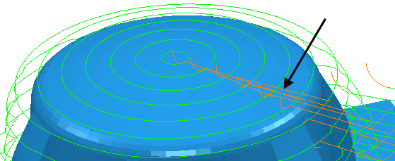

Type — Select the type of Lead in move to use before each cutting move.
Distance — Enter the distance to extend the Lead in move before the cutting move starts. If this is an arc move, then the distance is the length of the linear tangential move between the arc and the cutting portion of the toolpath.

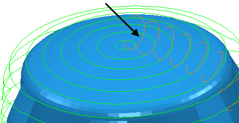

A Lead in of Surface normal arc with a Distance of 0, an Angle of 90 and a Radius of 5.

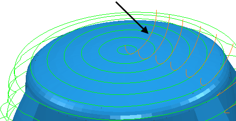

Angle — Enter the angle of the Lead in move relative to the toolpath segment. For arcs, this is the angle spanned by the arc. For lines, it is the orientation relative to the cutting move.

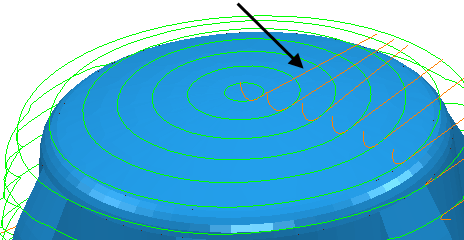

For a Lead in of Straight and Angle of 0

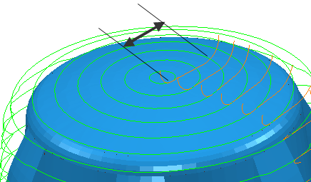

Radius — Enter the radius of the Lead in arc move.
