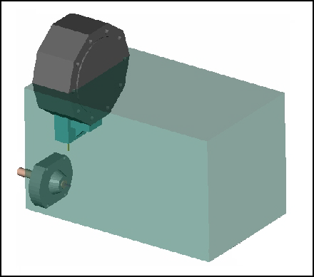

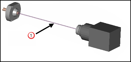

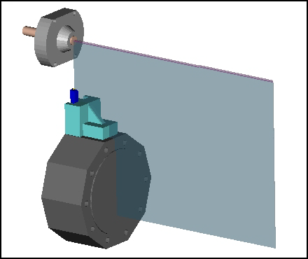

There are three ways to define travel limits. If the machine component can move in:
