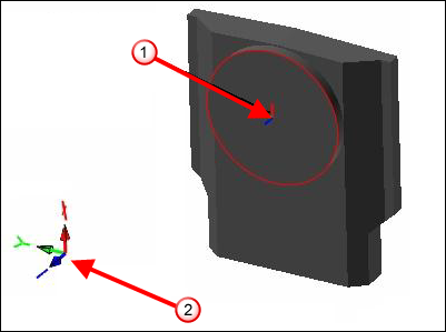

Tool posts/spindles
For tool posts or spindles, the reference point must coincide with the Solid Model Coordinate System Origin (see Machine description for Full Machine Simulation for reference point positions for tool posts).
Warning: If the reference point does not coincide with the Solid Model Coordinate System Origin, the tool post or spindle may not work as expected during simulation.
The orientation of the solid model relative to the three coordinate axes should be the same as its expected orientation in the Machine Coordinate System. The example below shows an XY turret that will perform a tool index about the Z-axis.

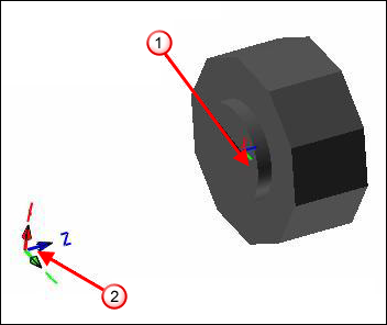

End working slide tool post with sub-spindle attached
The tool post must be set as described above, with the exception that the zero point of the endworking slide must coincide with the attachment point of the sub-spindle on the slide (as opposed to the face of the sub-spindle).
