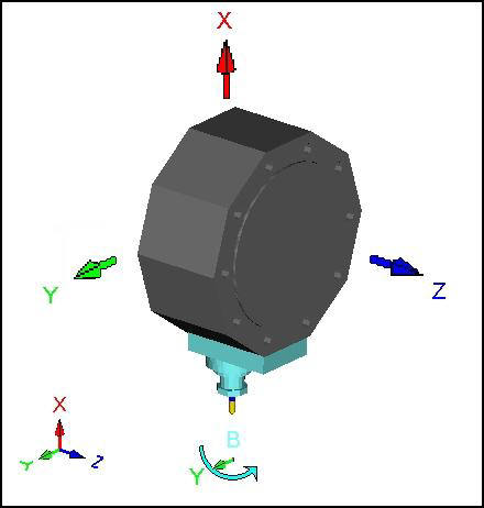

Motion Axes
Motion axes are defined in the Machine Data dialog for each machine component. They specify the directions in which a machine component can move. Enabling the X, Y, or Z motion axis allows the machine component to move in that axis during simulation. The B-axis applicable to the tool head and turrets allows the machine component to rotate about the Y-axis. The B-axis applicable to the gang allows a rotary attachment to rotate about the X or the Y axis (as specified on the Rotary Attachment dialog).
