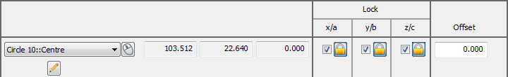

- point, select one or more check boxes in the Lock column to specify which axes are constrained by the feature. For example:
When you over-constrain an axis, PowerInspect creates a best-fit of all the features. Click
next to the check box to exclude the axis from the best-fit calculation. The button changes to

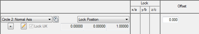

- line, axis, or vector, select an option from the right drop-down list. Select:
Lock Position to use the feature to constrain the position and translation axes.
Lock Direction to constrain only the rotation axes. For example:

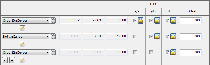

- Repeat steps 5 to 8 to specify the other features with which you want to create the alignment. For example:
Axes can be locked in any arrangement; you can specify up to 100 constraining items. If the alignment is over-constrained, PowerInspect creates the best-fit of the items you specified to include in the optimization, and reports their standard deviations in the alignment dialog, and in the Report tab.
