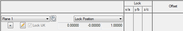

- Select the plane in the left drop-down list, or click
and select the feature in the CAD view. For example:
This locks the two rotation axes determined by the orientation of the plane.
- Choose an option in the right drop-down list. Select:
Lock Position to fix the orientation of the plane and lock the plane in position along its normal.
Lock Direction to fix the orientation of the plane. This locks two rotation axes, but leaves the position free to move along the axis normal to the plane.
