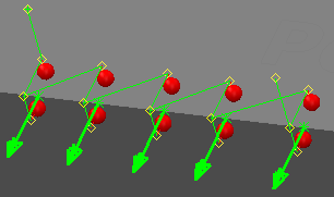

SurfaceSurfaceProbing to probe all the surface points before probing the corresponding edge points. For example:
SurfaceEdgeProbing to alternate between probing surface and edge points. For example:
