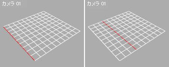

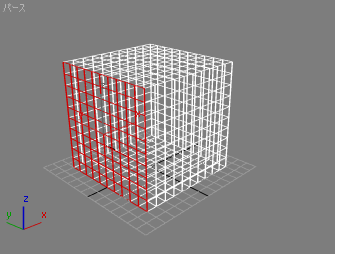

<Edit_Poly>.loopEdgeSel Integer default: 0 -- integer; Edge_Loop
[エッジ ループ](Edge Loop)の値を取得/設定します。3ds Max 8 以降 で使用可能です。
<Edit_Poly>.ringEdgeSel Integer default: 0 -- integer; Edge_Ring
[エッジ リング](Edge Ring)の値を取得/設定します。3ds Max 8 以降 で使用可能です。

例:
    --Create a box with 10x10x10 segments:
    b = box width:100 length:100 height:100 heightsegs:10 widthsegs:10 lengthsegs:10
    ep = Edit_Poly()--create an Edit_Poly modifier
    addModifier b ep--add the Edit_Poly modifier to the box
    max modify mode--switch to Modify tab of Command panel
    modPanel.setCurrentObject ep--set the Edit_Poly as the current level
    subObjectLevel = 3--switch to Border level
    --Now print the selection level using stand-alone interface access:
    format"Selection Level Is: %\n"(EditPolyMod.GetEPolySelLevel ep)
    --Now print the Mesh selection level using interface access via the modifier:
    format"Mesh Selection Level Is: %\n"(ep.EditPolyMod.GetMeshSelLevel())
    subObjectLevel = 4--switch to Face level
    --Select a whole side of the box- last 100 polygons. Call the method
    --without explicitly specifying the EditPolyMod interface - still works:
    ep.Select #Face #{501..600}
    ep.convertSelection #Face #Edge--convert the face selection to edge selection
    subObjectLevel = 2--switch to edge mode to see the result
出力:
    $Box:Box01 @ [0.000000,0.000000,0.000000]
    Edit_Poly:Edit Poly
    OK
    OK
    OK
    3
    Selection Level Is: #Border
    OK
    Mesh Selection Level Is: #edge
    OK
    4
    true
    220
    2

例:
    p = plane width:100 length:100 widthsegs:10 lengthsegs:10--create a plane
    addModifier p ep--add modifier to the plane
    max modify mode--switch to modify mode
    select p--select theplane
    subObjectLevel = 2--switch to Edge mode
    ep.select #Edge #{1}--select first edge
    ep.ButtonOp #SelectEdgeLoop--select Loop using the first edge
    ep.RingSelect 3 true false--shift the selection by 3
可能な引数の組み合わせをすべて使用して、1 つまたはすべてのエッジ ループを 3 つずつずらします。
MoveOnly Add 結果:
true false
true false
true true
true true
false true
false true
false false
false false
