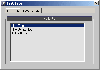

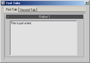

    rollout firstRollout "Rollout 1" (
    edittext edittext01 text:"This is just a test." height:135 width:262 )
    rollout secondRollout "Rollout 2" (
    listbox listbox02 items:#("Line One","MAXScript Rocks","ActiveX Too") width:260 )
    rollout testTabs "Test Tabs" (
    activeXcontrol ax_tabs "MSComctlLib.TabStrip.2" height:20
    subRollout theSubRollout height:180
    on ax_tabs Click do
    case ax_tabs.SelectedItem.index of
    1: (
    removeSubRollout theSubRollout secondRollout
    addSubRollout theSubRollout firstRollout
    2: (
    removeSubRollout theSubRollout firstRollout
    addSubRollout theSubRollout secondRollout
    on testTabs open do
    ax_tabs.tabs[1].caption = "First Tab"
    ax_tabs.tabs.add pvCaption:"Second Tab"
    )--end rollout
    createDialog testTabs 340 220
    addSubRollout testTabs.theSubRollout firstRollout
