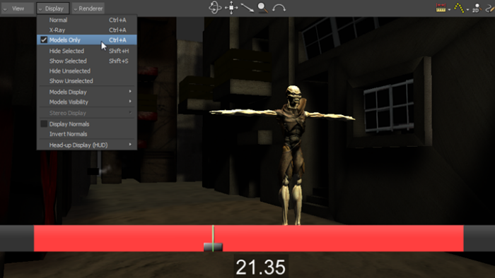

The following figure shows the Models-Only display mode.

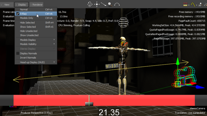

The following figure shows how the X-ray and Normal display mode draw extra elements in the viewport.

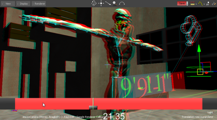

In the stereo display mode, the Render() function is called twice per frame/per view pane (once for the left and right eyes respectively), and composite both the buffers accordingly (if not using the active stereo mode).

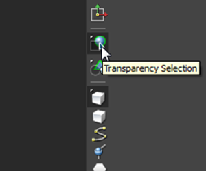

Using these additional properties, MotionBuilder can dynamically adjust its runtime behaviour according to the current choice of renderer. For example, if you set SupportIDBufferPicking to be false, picking in Transparency Selection mode does not work as expected, and instead MotionBuilder performs the default GL selection buffer based picking.
The Transparency Selection mode (as shown in the following figure) works only when the selected custom renderer’s SupportIDBufferPicking property is true.
