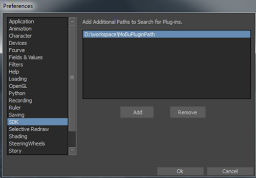

After the project is built successfully, the resulting library is saved in MOTIONBUILDER_PLUGIN_PATH environment variable or by using the Preferences dialog as shown in the following figure.
The plug-ins that are saved in these specified folders are automatically loaded at startup.

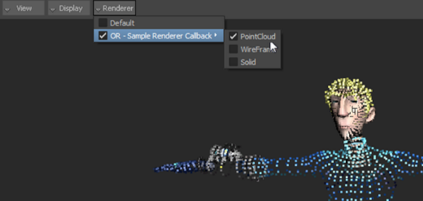

Run MotionBuilder. An additional Renderer menu appears. You can choose a method for rendering the scene as shown in the following figure.
