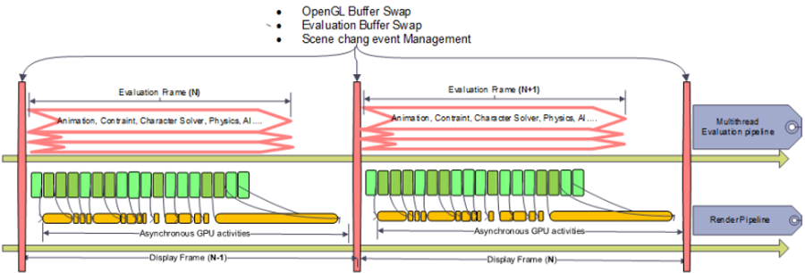

MotionBuilder uses the multiple concurrent pipeline and double data buffer mechanism for high performance evaluation and rendering as shown in the following figure.
Adapting the multiple data buffer mechanism reduces the explicit need of lock and improves the pipeline’s throughput as shown in the figure. In this architecture, the evaluation pipeline can evaluate the scene for the next frame in the evaluation data buffer, while the rendering pipeline can display the scene for the current frame using the data in the display buffer. On swapping data, the indexes of the two buffers are exchanged. After a short time interval for event processing (for example, mouse, keyboard, or other user or system events), the next frame is processed with each pipeline working on alternative data buffers.
The tasks in the evaluation pipeline are distributed to multiple threads after the directed acyclic graph (DAG) dependency sorting. The geometry deformation tasks can be either executed in parallel on multiple CPUs in the evaluation pipeline after the depended transformation evaluation tasks, or collectively in the graphics processing unit (GPU) at the beginning of the rendering pipeline for better performance, if a CUDA™ enabled video card is available.

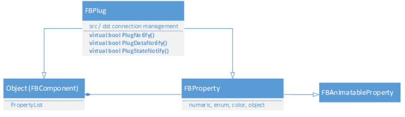

Most of the SDK object classes are inherited from the FBPlug class, which provides a set of low level functions to manage the source (child) and destination (parent) connections between the plug instances. It also provides three important virtual functions: FBPlug::PlugNotify(), FBPlug::PlugDataNotify(), and FBPlug::PlugStateNotify(). These functions can be overridden in the subclasses to receive notifications when there are changes in the internal state of the instances.
The following figure shows the plug based object model in MotionBuilder:
The most important subclasses are FBComponent and FBProperty. An instance of FBComponent owns a list of properties (FBComponent::PropertyList). The connection between the two object instances and the various value (or state) changing events on owned properties trigger callback events in the PlugNotify() (or PlugDataNotify() and PlugStateNotify()) function. The FBProperty subclass can contain various type of raw data (FBPropertyBool, FBPropertyInt, FBPropertyColor, and others), and it also provides a uniform mechanism to organize the object’s attributes either using scalar or time varied (FBAnimatableProperty) values.

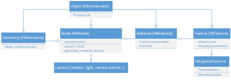

Most objects in the ORSDK (including model, locator, geometry, material, textures, and others) are inherited from the FBComponent class. The following figure shows the model, locator, geometry, material, and texture class hierarchy.

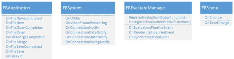

You can use a set of callback events (type of FBPropertyEvent and its subclasses) in some global singleton objects to write code that can listen to the following:
FileNew, FileOpen, and FileExit in FBApplication.FBSystem::OnConnectionNotify.You can use wildcard searching (FBPropertyEvent*) in the ORSDK header files to collect the complete list of event properties. The following figure shows the frequently used event properties in singleton objects.
