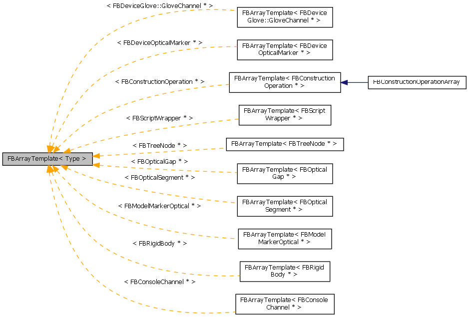

Inheritance diagram for FBArrayTemplate< Type >:
