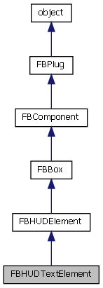

Heads Up display. More...
Public Member Functions | |
| FBHUDTextElement (str pName) | |
| Constructor. More... | |
| FBStringList | GetFontList () |
| Returns a list of supported fonts. More... | |
Public Member Functions inherited from FBBox | |
| FBBox (str pName) | |

Heads Up display.
Text element. Render text with a background rectangle to the HUD.
