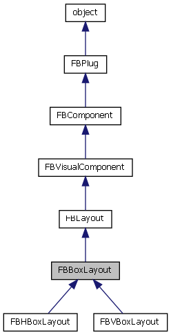

Inheritance diagram for FBBoxLayout:

Detailed Description
Base class for a line layout (either vertical or horizontal)
This class is made to ease the creation of Tool in Python. It manages
all the 'FBLayout' region stuff (no need to use FBAddRegionParam anymore!).
Generally you just Add a Control to the layout specifying some parameters.
There are 2 kinds of Add: Add with fixed size and AddRelative which ensure
the control Added will occupy a 'percentage' of the available space AFTER the
fixed space has been assigned.
