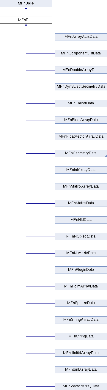

Inheritance diagram for MFnData:Public Types | |

Reimplemented in MFnFalloffData, MFnPluginData, MFnNurbsSurfaceData, MFnDynSweptGeometryData, MFnNurbsCurveData, MFnSubdData, MFnMeshData, MFnNumericData, MFnArrayAttrsData, MFnDoubleArrayData, MFnFloatArrayData, MFnSphereData, MFnFloatVectorArrayData, MFnGeometryData, MFnNIdData, MFnUintArrayData, MFnMatrixData, MFnComponentListData, MFnIntArrayData, MFnMatrixArrayData, MFnPointArrayData, MFnStringArrayData, MFnStringData, MFnUInt64ArrayData, MFnVectorArrayData, MFnLatticeData, and MFnNObjectData.
