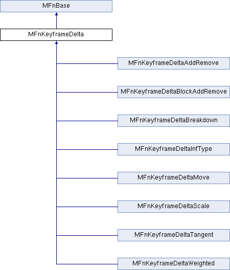

Inheritance diagram for MFnKeyframeDelta:Public Member Functions | |

Public Member Functions inherited from MFnBase | |

Reimplemented in MFnKeyframeDeltaTangent, MFnKeyframeDeltaBlockAddRemove, MFnKeyframeDeltaInfType, MFnKeyframeDeltaMove, MFnKeyframeDeltaAddRemove, MFnKeyframeDeltaScale, MFnKeyframeDeltaBreakdown, and MFnKeyframeDeltaWeighted.
