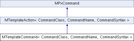

Inheritance diagram for MTemplateCommand< CommandClass, CommandName, CommandSyntax >:Public Member Functions | |

Template class for undoable commands.
Helper template class which make writing undoable commands easier.
