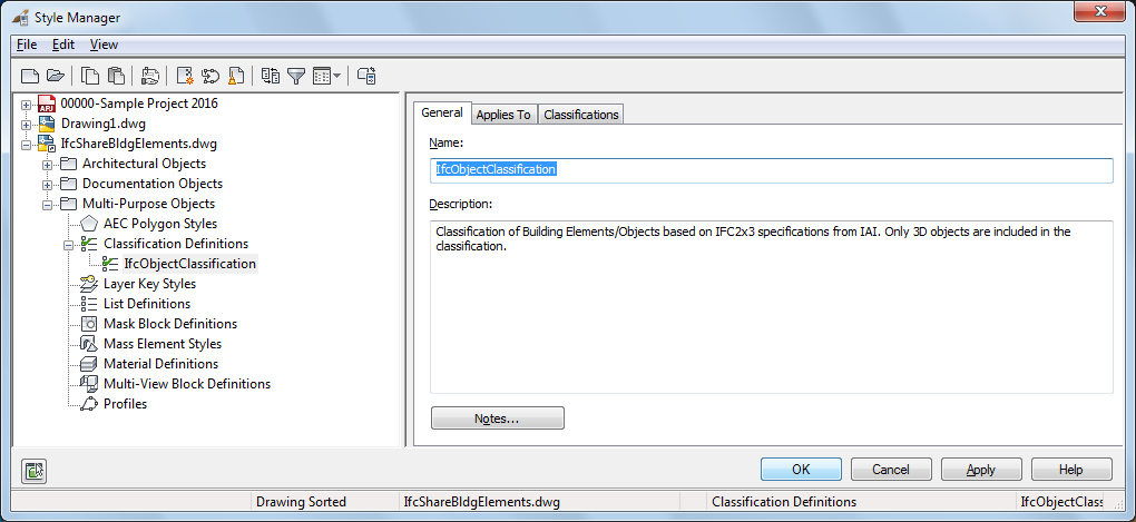

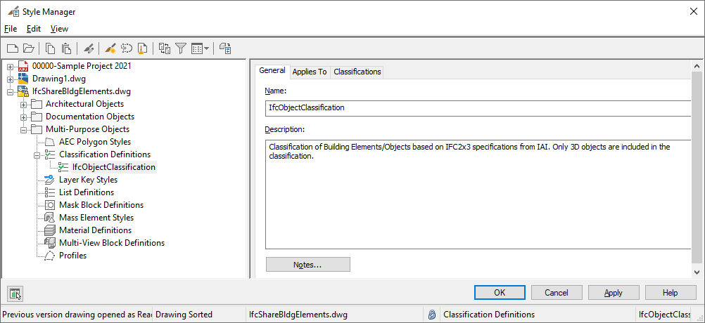

- On the left pane of the Style Manager, expand your drawing
Multi-Purpose Objects
Classification Definitions and select IfcObjectClassification.
- Click the Applies To tab, select the objects you want the classification definition to apply and click OK.

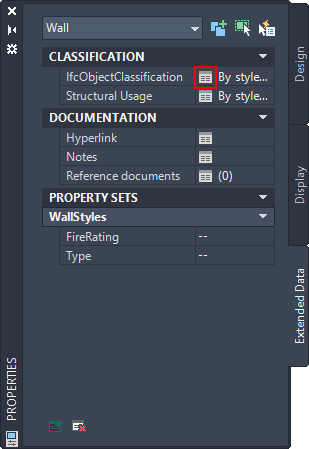

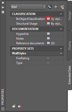

- In the drawing, select the objects to classify.

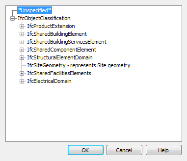

- In the Properties palette, on the Extended Data tab, under Classification panel, click IfcObjectClassification and select the classification.
- Click OK.
