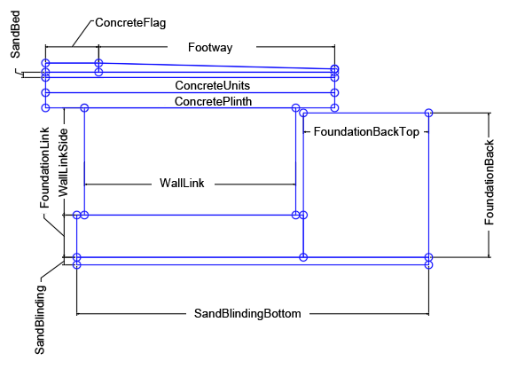

The RailPlatform subassembly includes common layers for rail platforms such as walls, concrete plinth, footway, sand bed, foundation and so on.

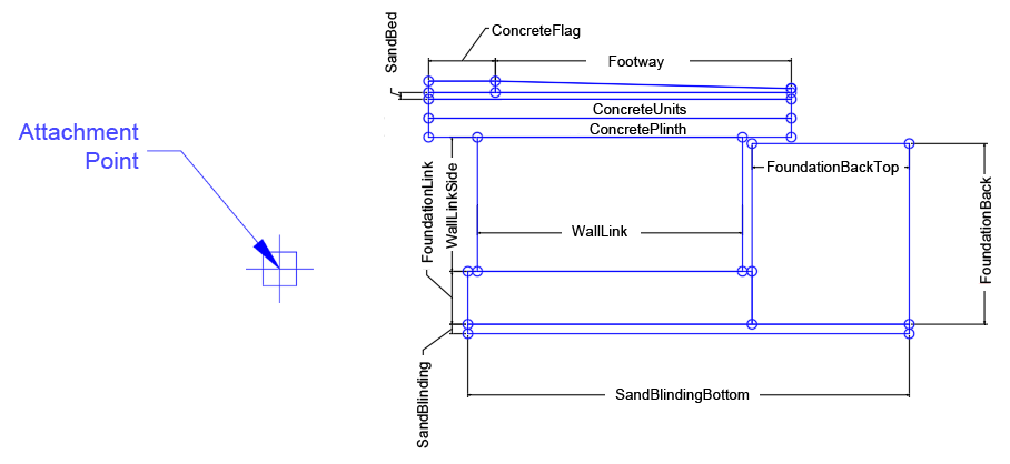

This subassembly provides a rail platform that attaches to a rail alignment. Place the platform subassembly insertion point on the centreline alignment and profile of the rail and adjust the behaviour by setting the input parameters and optional target parameters listed above.
In layout mode, this subassembly draws the rail platform.
The following table lists the point, link and shape codes for this subassembly that have codes assigned to them. Point, link or shape codes for this subassembly that do not have codes assigned are not included in this table.
Point, Link or Shape |
Code |
Description |
| P1 | WallBottomLeft | Wall Bottom Left |
| P2 | WallTopLeft | Wall Top Left |
| P3 | WallTopRight | Wall Top Right |
| P4 | WallBottomRight | Wall Bottom Right |
| P5 | PlinthBottomLeft | Plinth Bottom Left |
| P6 | PlinthTopLeft | Plinth Top Left |
| P7 | PlinthTopRight | Plinth Top Right |
| P8 | ConcreteUnitsTopLeft | Concrete units Top Left |
| P9 | ConcreteUnitsTopRight | Concrete Units Top Right |
| P10 | SandBedTopLeft | Sand Bed Top Left |
| P11 | SandBedTopRight | Sand Bed Top Right |
| P12 - P13 | PlatformEdge | Platform Edge |
| P14 | PlatformEdgeBottom | Platform Edge Bottom |
| P15 | Top, FootwayRightEdge | Footway Right Edge |
| P16 | FoundationRightEdge | Foundation Right Edge |
| P17 | FoundationBottomRight | Foundation Bottom Right |
| P18 | FoundationBottomLeft | Foundation Bottom Left |
| P19 | FoundationEdgeLeft | Foundation Edge Left |
| P20 | PlinthBottomRight | Plinth Bottom Right |
| P21 | SandBlindingRightTop | Sand Blinding Right Top |
| P22 | SandBlindingRightBottom | Sand Blinding Right Bottom |
| P23 | SandBlindingLeftBottom | Sand Blinding Left Bottom |
| P24 | FoundationBackTopLeft | Foundation Back Top Left |
| P25 | FoundationBackTopRight | Foundation Back Top Right |
| L1 | WallLinkSide | Wall Link Side |
| L2 | WallLinkTop | Wall link Top |
| L3 | WallLinkSide | Wall Link Side |
| L4 | WallLinkBottom | Wall Link Bottom |
| L5 | ConcretePlinthLink | Concrete Plinth Link |
| L6 | ConcretePlinthLinkTop | Concrete Plinth Link Top |
| L7 | ConcretePlinthLink | Concrete Plinth Link |
| L8 | ConcretePlinthLinkBottom | Concrete Plinth Link Bottom |
| L9 | ConcreteUnitLink | Concrete Unit Link |
| L10 | ConcreteUnitLinkTop | Concrete Unit Link Top |
| L11 | ConcreteUnitLink | Concrete Unit Link |
| L12 | ConcreteUnitLinkBottom | Concrete Unit Link Bottom |
| L13 | SandBedBottomLeft | Sand Bed Bottom Left |
| L14 | SandBedLinkTop | Sand Bed Link Top |
| L15 | SandBedBottomRight | Sand Bed Bottom Right |
| L16 | SandBedLinkBottom | Sand Bed Link Bottom |
| L17 | ConcreteFlagLink | Concrete Flag Link |
| L18 | ConcreteFlagLink, Top | ConcreteFlagLink, Top |
| L19 - L20 | ConcreteFlagLink | Concrete Flag Link |
| L21 | Footway, Top | Footway |
| L22 | FootwayLink | Footway Link |
| L23 | FootwayLinkBottom | Footway Link Bottom |
| L24 | FootwayLink | Footway Link |
| L25 - L28 | FoundationLink | Foundation Link |
| L29 | SandBlindingTop | Sand Blinding Top |
| L30, L32 | SandBlinding | Sand Blinding |
| L31 | SandBlindingBottom | Sand Blinding Bottom |
| L33, L35 | FoundationBack | Foundation Back |
| L34 | FoundationBackTop | Foundation Back Top |
| L36 | FoundationBackBottom | Foundation Back Bottom |
| S1 | Wall | Wall |
| S2 | ConcretePlinth | Concrete Plinth |
| S3 | ConcreteUnits | Concrete Units |
| S4 | SandBed | Sand Bed |
| S5 | ConcreteFlag | Concrete Flag |
| S6 | Footway | Footway |
| S7 | Foundation | Foundation |
| S8 | SandBlinding | Sand Blinding |
| S9 | FoundationBack | Foundation Back |
