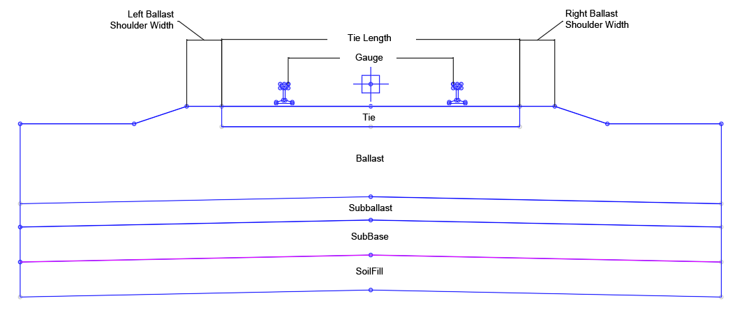

Tie Length Length of the tie (also known as sleeper). Numeric, non-negative
8.5'
2.59 m
Tie Depth Depth of tie Numeric, non-negative 7"
178 mm
Minimum Ballast Depth The minimum vertical distance between the bottom of the tie and the top of the subballast. The location of this minimum distance changes at different stages in cant. See Behaviour below. Numeric, non-negative 12"
305 mm
Ballast Shoulder Width (Left and Right) The distance from the end of the tie to the beginning of the ballast side slope. Numeric, non-negative 12"
305 mm
Ballast Side Slope (Left and Right) The slope of the sides of the ballast material. The slope of the top of the ballast material matches the slope of the tie that results from cant. Slope, non-negative 2:1

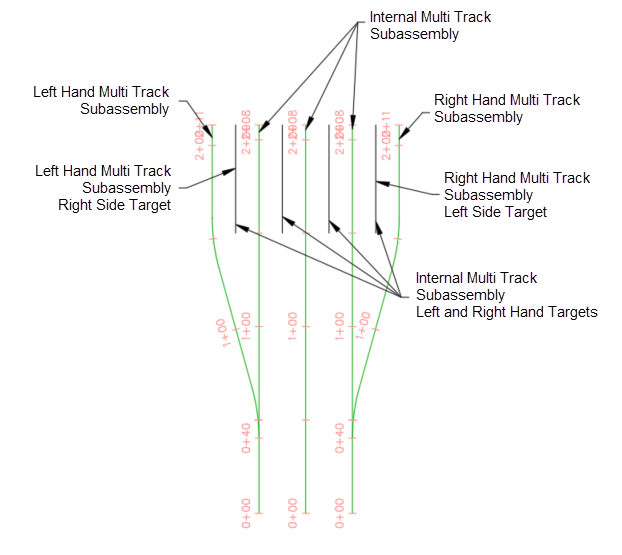

This subassembly works in multi-track situations in conjunction with the Left Hand Multi Track Subassembly and/or the Right Hand Multi Track Subassembly. With these subassemblies, each rail line has its own alignment and profile. Place this subassembly internally to the left hand alignment and profile and/or the right hand alignment and profile. Control the left and right edge locations of the subassembly with the input parameters or with the target parameters provided. Target lines between the right hand alignment, left hand alignment and/or other internal rail alignments.

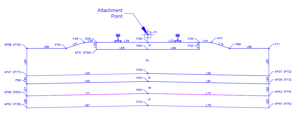

In layout mode the subassembly displays the links comprising the rails, tie, ballast, subballast and side slopes.
Point, Link and Shape Codes
The following table lists the point, link and shape codes for this subassembly that have codes assigned to them. Point, link or shape codes for this subassembly that do not have codes assigned are not included in this table.
Point, Link or Shape
Code
Description
P1, P4-P27, P58-P59 Rail Rail
P2 Cl_Rail Centreline of Rail
P3 Gauge_Line, Rail Gauge line (inside edge of top of rail)
P28-P32, P60 Tie Tie
P54-P55, P45, P47, P71-P72, P76 Ballast Ballast
P53, P73 Subballast Subballast
P62-P63, P74 SubBase SubBase
P70, P75, P78 Soil Fill Soil Fill
L1, L2 Top_Rail, Rail Top of rail
L3-L28 Rail Rail
L29-L33, L65-L66 Tie Tie
L40-41, L44, L55-L56, L63, L79-L80, L84, L88-L89 Ballast Ballast
L59-L60, L81, L85 Subballast Subballast
L67, L71-L72, L82 SubBase SubBase
L78, L83, L86-L87 Soil Fill Soil Fill
S1, S2 Rail Rails
S3 Tie Tie
S4 Ballast Ballast
S5 Subballast Subballast
S6 SubBase SubBase
S7 SoilFill SoilFill
