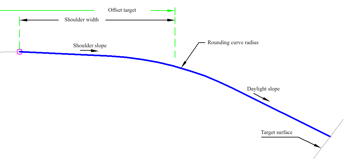

ShoulderRoundedTarget
The ShoulderRoundedTarget subassembly provides rounding of a shoulder.
The shoulder is measured from the attachment point to the VIP of the rounding. If the distance between the VIP and the target surface is not adequate to provide the rounding curve, the rounding curve value is reduced to fit. You can define the geometry of the rounded shoulder.
The attachment point is at the inside edge of the paved shoulder, which is typically at the outside edge of carriageway.

The VIP location of the rounded curve is calculated by using the input parameters or, if set, the offset target. A temporary daylight link is then calculated. Then the curve is calculated and the remaining points and links are added to the subassembly.
Layout Mode Operation
In layout mode the subassembly displays the links comprising the shoulder.

Coding Diagram
