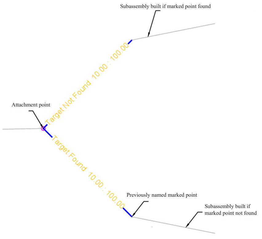

In layout mode, this subassembly draws a line using the Layout Width and Layout Gradient input parameter values. This line represents the location in the assembly where the ConditionalMarkedPoint subassembly is applied.
Point, Link and Shape Codes
Unlike most other subassemblies, the ConditionalMarkedPoint subassembly doesn't create any points, links or shapes in modelling mode.
Coding Diagram
The following coding diagram shows the points and links that are created in layout mode. No point, link or shape codes are created for this subassembly in modeling mode.
