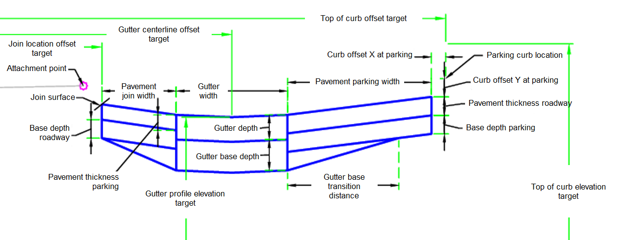

The ParkingAdjacentToRoad subassembly builds a parking area adjacent to an existing carriageway. The parking includes a paved area of the existing carriageway, a channel and a parking pavement. The parking pavement ties into a proposed kerb level and top of kerb location.
The attachment point is at a point at the centre of the carriageway. This component can be attached to either the left or right side.

Side Specifies which side to place the subassembly. Left / Right Right
Channel Width Entire width of the channel Numeric, positive
3 ft
1 m
Channel Depth Channel depth Numeric, positive
8 in
200 mm
Pavement Thickness Parking AC pavement thickness Numeric, positive
2 in
50 mm
Channel Base Transition Distance Transition of thicker base at channel Numeric, positive
3 ft
1 m
Kerb Offset Y At Parking Kerb offset Y at back of parking Numeric
-0.5 ft
-0.150 m
Kerb Offset X At Parking Kerb offset X at back of parking Numeric
-0.625 ft
-0.19 m
Pavement Parking Width Pavement parking width Numeric, positive
20.5 ft
6.25 m
Channel Base Depth Pavement join width Numeric, positive
2 ft
0.6 m
Base Depth Parking Base depth under channel Numeric, positive
6 in
150 mm
Base Depth Carriageway Base depth carriageway Numeric, positive
10 in
250 mm
Pavement Thickness Carriageway Pavement thickness carriageway Numeric, positive
3 in
80 mm

Join Location Used to determine the join width from the attachment point. The following object types can be used as targets for specifying the width: alignments, polylines, feature lines or survey figures. Required
Join Surface Used to determine the join level. The following object types can be used as targets for specifying the surface: surfaces. Required
Top of Kerb Offset Used to determine the top of kerb level of the tie-in location of parking kerb. The following object types can be used as targets for specifying the level: profiles, 3D polylines, feature lines, or survey figures. Required
Top of Kerb Profile Used to determine the offset location for kerb and channel. The following object types can be used as targets for specifying the level: profiles, 3D polylines, feature lines, or survey figures. Required
Channel Centreline Used to determine the channel centreline location. The following object types can be used as targets for specifying the width: alignments, polylines, feature lines or survey figures. Required
Channel Profile Used to determine the centreline level of the channel. The following object types can be used as targets for specifying the level: profiles, 3D polylines, feature lines or survey figures. Required

The initial reference point is set at the attachment point. The top of kerb profile and offset values are found to determine the location of the outer edge of the parking pavement. The join location is determined from the join location target. The join level is found based on the join location and the join surface target at this point. The channel location and channel level are determined from the set targets. The channel geometry is then built based on the input parameters. The pavement join geometry is built from the target join levels and input parameters. Then the parking pavement is built using the target values and input parameters.
