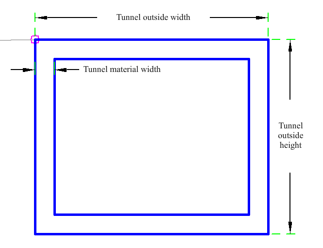

SimpleTunnel
The SimpleTunnel subassembly is for a simple tunnel, or box culvert. It uses the height, width, and material thickness that you input.
The attachment point is the uppermost point on the links preceding the tunnel.

Behavior
The points, links, and shapes are created using the input parameters.
Layout Mode Operation
In layout mode the subassembly displays the links comprising the tunnel.
