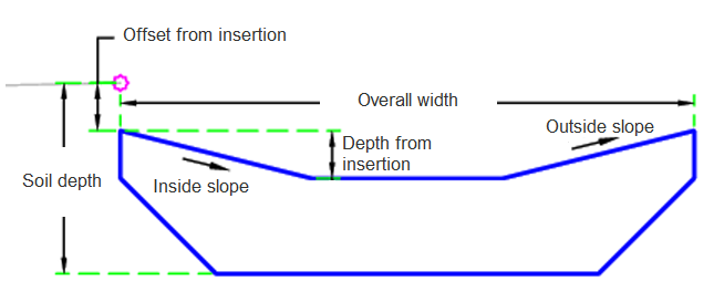

The ClarkCountyRainGardenNoKerb subassembly inserts links to create a Clark County Rain Garden with no kerb.
You should verify that the dimensions used match your interpretation of the standard plan.
The attachment point is at the inside edge of the inside slope. This component can be attached to either the left or right side.
Input Parameters
Note: Note: All dimensions are in metres or feet unless otherwise noted. All slopes are in run-over-rise form (for example, 4 : 1) unless indicated as a percent slope with a “%” sign.

Side Specifies which side to place the subassembly. Left / Right Right
Overall Width Overall width of rain garden Numeric, positive
12.0 ft
3.6 m
Soil Depth Soil depth of rain garden Numeric, positive
2 ft
0.6 m
Inside Slope Inside slope Slope -4 ( : 1)
Outside Slope Outside slope Slope -4 ( : 1)
Depth From Insertion Depth from insertion Numeric
-1 ft
0.3 m
Offset From Insertion Offset from insertion Numeric
0 ft
0 m

The initial point is set at the attachment point. The rain garden is then adjusted the entered offset distance. The depth of the rain garden is set from the input values.
Layout Mode Operation
In layout mode, this subassembly draws the rain garden in accordance with the input parameters.
