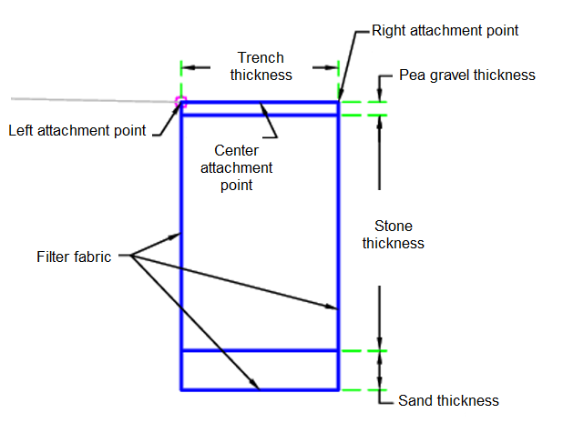

The initial point is set at the attachment point. The subassembly builds the shape for the infiltration trench.
Layout Mode Operation
In layout mode, this subassembly displays the infiltration components based on the input parameters given.

P1, P2 PeaGravel Top of pea gravel layer
P3, P4 Stone Top of stone layer
P5 - P6 Sand Top of sand layer
P7-P8 Sand_Datum Bottom of sand layer
L1 Top Top layer
L2 PeaGravel, FilterFabric Pea gravel layer; if Include Filter Fabric parameter is set to Yes, then filter fabric is included
L3, L4 Sand, Datum Top of sand layer
S1 Stone Stone layer
S2 Sand Sand layer
S3 PeaGravel Pea gravel layer
Coding Diagram
