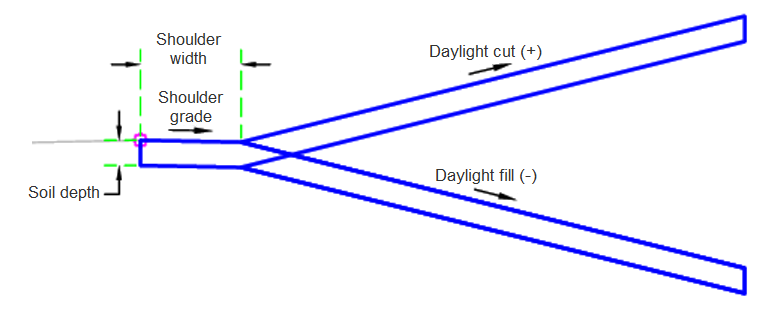

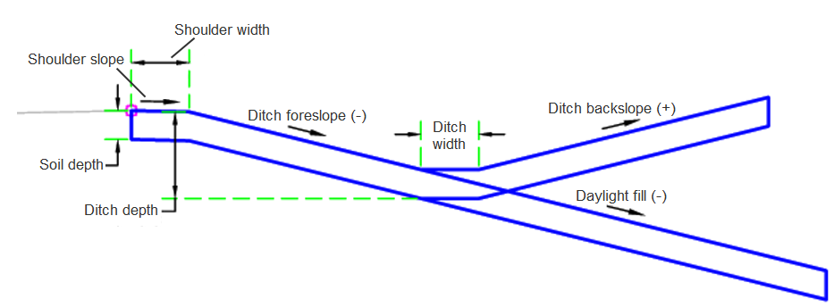

The ClarkCountyBasicDaylight subassembly inserts links to create cut or fill catch slopes with a shoulder. You can define a ditch in cut situations.
You should verify that the dimensions used match your interpretation of the standard plan.
Case 1: With Ditch
Case 2: Without Ditch

The attachment point is at the inside edge of the initial cut or fill slope. This component can be attached to either the left or right side.
Input Parameters
Note: Note: All dimensions are in metres or feet unless otherwise noted. All slopes are in run-over-rise form (for example, 4 : 1) unless indicated as a percent slope with a “%” sign.

Side Specifies which side to place the subassembly. Left / Right Right
Daylight_Cut (+) Daylight cut slope Numeric, positive 4 ( : 1)
Daylight_Fill (-) Daylight Fill Slope Numeric, negative -4 ( : 1)
Shoulder Width Optional Shoulder Width Numeric, positive
1 ft
0.3 m
Shoulder Slope Only if shoulder is used Numeric -2 (%)
Soil Depth Optional Soil Depth Numeric, positive
0.5 ft
0.15 m
Ditch Depth Ditch depth from attach point Numeric
1 ft
0.3 m
Ditch ForeSlope (-) Ditch Fore Slope Numeric -4 ( : 1)
Ditch BackSlope (+) Dich Back Slope Numeric, positive 4 ( :1 )

The initial shoulder or hinge point is set at the attachment point. If the shoulder is built if the shoulder width is larger than zero. The hinge point level is checked against the target surface to determine if the section is in the cut or fill condition. If in cut, the ditch is determined if it needs to be built. Then an intercept is calculated to the target surface using the given Daylight Slope.
Layout Mode Operation
In layout mode, this subassembly draws the initial fill slope to 5 ft (1.5 m).
