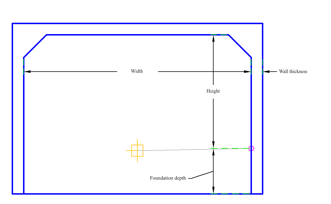

SimpleTunnelOpenBottom
The SimpleTunnelOpenBottom subassembly is for a simple tunnel with open bottom. It uses the height, width, and material thickness that you input.
The attachment point is the bottom center of the tunnel.

Width Double Input Inside width of the tunnel Numeric, positive
10 ft
3 m
Tunnel Height Inside height of the tunnel Numeric, positive
5 ft
1.5 m
Wall Thickness Width of the walls, and roof of the tunnel Numeric, positive
0.5 ft
.15 m
Shape Name A list of codes to be assigned to the tunnel shape Comma-separated string Tunnel
Tunnel Ceiling link A list of codes to be assigned to the ceiling link Comma-separated string TunnelCeiling
Tunnel Inside Wall Link A list of codes to be assigned to the inside wall link Comma-separated string TunnelInsideWall
Tunnel Top Link A list of codes to be assigned to the top link Comma-separated string TunnelTop
Tunnel Outside Wall Link A list of codes to be assigned to the outside wall link Comma-separated string TunnelOutsideWall
Foundation Depth Depth of the tunnel walls below the tunnel floor Numeric, positive
5 ft
1.5 m
Tunnel Top Right Code A list of codes to be assigned to the top right point Comma-separated string TunnelTopRight
Tunnel Top Left Code A list of codes to be assigned to the top left point Comma-separated string TunnelTopLeft

Behavior
The points, links, and shapes are created using the input parameters.
Layout Mode Operation
In layout mode the subassembly displays the links comprising the tunnel.

Coding Diagram
