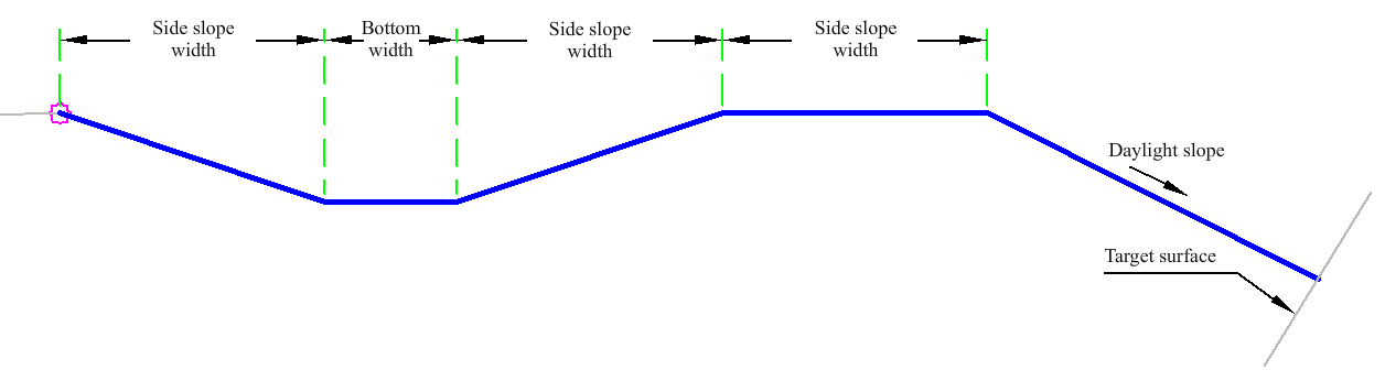

The subassembly builds the shape for a ditch using the input parameters. Once the ditch shape is built the ditch is determined to be in cut or fill. If in cut, a daylight link is added using the daylight slope. If in fill, a benching is created using the side slope width.
Layout Mode Operation
In layout mode the subassembly displays the links comprising the ditch in the fill condition.

P1 Hinge, Top Attachment point, ditch start
P2 Top, Ditch_In Bottom of ditch nearest to attachment point
P3 Top, Ditch_Out Bottom of ditch farthest from attachment point
P4 - P5 Top
P6 Daylight Daylight point
L1 Top, Ditch_In
L2 Top, Ditch_Bottom
L3 Top, Ditch_Out
L4 - L5 Top
Coding Diagram
