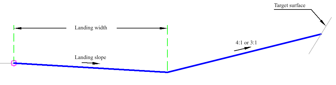

The SimpleCutWithLanding subassembly allows a simple landing / shoulder with a cut option. The subassembly only daylights in a cut situation.

The landing is drawn using the input parameters. The height to daylight is then calculated. If the distance is less than 25 ft (7.5 m) a daylight slope of 4:1 is used. If the height is less than 35 ft (10.5 m) a daylight slope of 3:1 is used. Otherwise a daylight slope of 2:1 is used.
If in fill, the daylight slope is not created.
Layout Mode Operation
In layout mode the subassembly displays the links comprising the landing and a link for the daylight in cut.

P1 Top, Hinge
P2 Top, LandingOuter Outer Landing Point
P3 Daylight_point Daylight Point
L1, L2 Top
