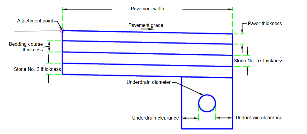

The PermeablePavement subassembly inserts links and shapes to create permeable pavement pavers with an optional underdrain.
The attachment point is at the inside edge of the permeable pavement. This component can be attached to either the left or right side.
Input Parameters
Note: Note: All dimensions are in metres or feet unless otherwise noted. All slopes are in run-over-rise form (for example, 4 : 1) unless indicated as a percent slope with a “%” sign.
Parameter
Description
Type
Default
Side Specifies which side to place the subassembly. Left / Right Right
Paver Thickness Paver thickness Numeric, positive
0.26 ft
0.08m
Bedding Course Thickness Bedding course thickness Numeric, positive
0.17 ft
0.05 m
Stone No. 57 Thickness Thickness of stone No. 57 Numeric, positive
0.33 ft
0.10 m
Stone No. 2 Thickness Thickness of stone No. 2 Numeric, positive
0.5 ft
0.15 m
Include Underdrain Should include underdrain Yes / No Yes
Underdrain Diameter Diameter of diameter Numeric, positive
0.5 ft
0.15 m
Underdrain Clearance Distance of rock around underdrain Numeric, positive
0.5 ft
0.15 m
Pavement Width Width of pavement Numeric, positive
24 ft
7.3 m
Include Impermeable Liner Includes an impermeable liner under the pavement section Yes / No No
Pavement Gradient Pavement gradient Numeric -2%

The slope of the permeable pavement is determined by the input parameters or, if set, the offset targets. The shape of the permeable pavement is built from the input parameters. If set to use an underdrain, an underdrain pipe and surrounding material is constructed. The location of the underdrain is at the edge of the pavement, unless the targets change the location and level. If set to include an impermeable liner, link codes are assigned to the bottom and outer sides of constructed links.
