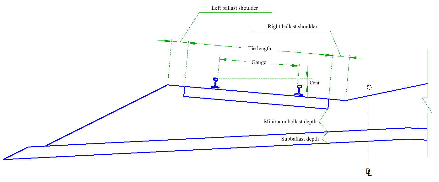

RailDoubleTrackCANT
The RailDoubleTrackCANT subassembly is used to insert the rails, ties, ballast, subballast, soil fill and subbase for a double-track railroad.
It should be followed with a Daylight subassembly on the left and right sides to close to existing ground in cut and fill situations. It is capable of responding to rail cant.

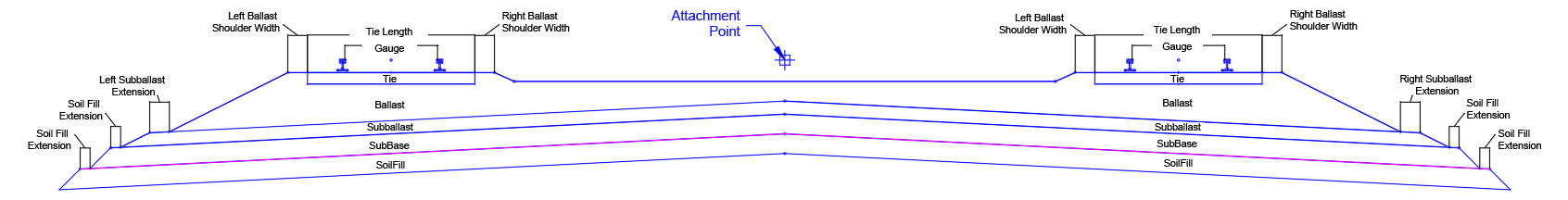

By default, the attachment point is at the centreline between the rails of the left track. The tracks can be moved relative to this point using the subassembly parameters.

Baseline to Right Track CL
The offset from the baseline alignment to the centreline of the left or right track.
Numeric
0
Baseline to Left Track CL
Numeric
20'
6m

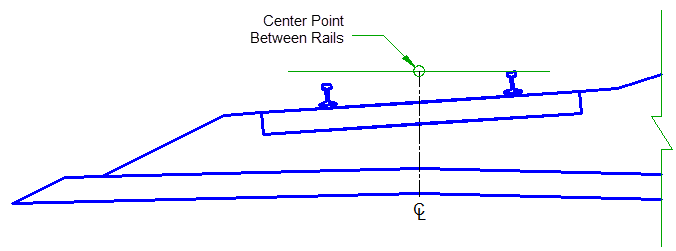

Track Level Difference (Left and Right)
The vertical offset between the profile grading point of the baseline and the centre point between the tracks. This value is overridden when a level target is applied to the track.
Numeric
0

Minimum Ballast Depth
The minimum vertical distance between the bottom of the tie and the top of the Subballast. The location of this minimum distance changes at different stages in cant. See "Behaviour" below.
Numeric, non-negative
12"
305 mm
Ballast Shoulder Width (Left and Right)
The distance from the end of the tie to the beginning of the ballast side slope.
1 ft
0.30 m
Ballast Side Slope (Left and Right)
The slope of the sides of the ballast material. The slope of the top of the ballast material matches the slope of the tie that results from cant.
Slope, non-negative

Subballast Depth
The depth of the subballast material
8"
203 mm
Baseline to Subballast Crown
The offset from the baseline to the crown of the subballast.
Numeric
10'
3 m
Subballast Top Slope
The top slope of the left and right sides of the subballast with the centreline of the subassembly as the hinge point.
Slope, non-negative
40:1
Subballast Extension (Left and Right)
The distance from the toe of the ballast material to the beginning of the side slope of the subballast material
12"
0.30 m
Subballast Slope
The slope of the side of the subballast material.
Slope, non-negative
2:1

Left Track Level
May be used to set the level of the centre point between the left rails. Cant is applied after this point is located so the actual point between rails may vary since rotation can occur around either of the rails.
Optional
Right Track Level
May be used to set the level of the centre point between the right rails. Cant is applied after this point is located so the actual point between rails may vary since rotation can occur around either of the rails.
Optional

Behavior
When no targets are applied, the location of either track is determined by the Left Track Offset, Right Track Offset, Left Track Elevation Difference and Right Track Elevation Difference. These values locate the centre points between the tracks. By default, the Left Track Offset is zero placing the centerline of the left track at the baseline. When target alignments and profiles are applied, these values are overridden. When using target alignments for the track centrelines, the tracks always remain perpendicular to the baseline, not the target alignment. When the target alignments are not parallel to the baseline alignment, distortion will occur and the track dimensions will not be accurately represented.
Important: The RailDoubleTrackCANT subassembly calculates cant from the single centre alignment and not from targets. True offset tracks may have different curve geometry and design speeds that the centreline calculation can not accommodate. This subassembly is for primary design. For accurate cant calculation, separate baselines modelling the Left and Right Multi Track subassemblies should be used.
When you apply rail cant information to the alignment baseline, the rails rotate accordingly. The point about which they rotate depends on the Pivot Method setting contained in the cant information for the alignment. If you set a Pivot Method to Low Side Rail, then the rail on the inside of the curve is held at track level and the level of the outside rail is adjusted an amount equal to the cant value.
If you set the Pivot Method to High Side Rail, then the rail on the outside of the curve is held at track level and the level of the inside rail is adjusted an amount equal to the cant value.
If you set the Pivot Method to Centre Baseline, then both rails are adjusted an amount equal to half the cant value, the outside rail upward and inside rail downward.
The Minimum Ballast Depth value applies at the location of the minimum clearance between the tie and subballast. The Subballast Top Slope parameter independently controls the subballast top slope . The Baseline to Subballast Crown parameter controls the location of the subballast crown.
