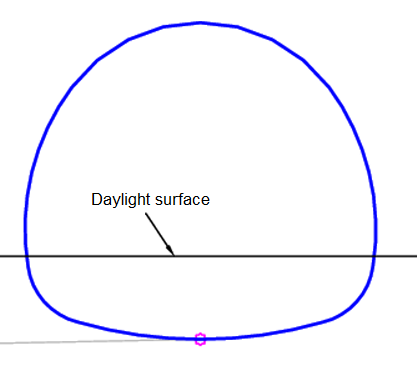

The initial point is set at the attachment point. If the daylight surface is below the plate bottom or above the rise dimension, the entire steel plate is built. If the daylight surface is within the interior of the steel plates, then the steel plate is partially constructed. Each plate angle is split into 10 sections comprising 10% of the plate angle. The sections are then tested until the daylight occurs within the section and no further processing of the sections occurs.

Coding Diagram
