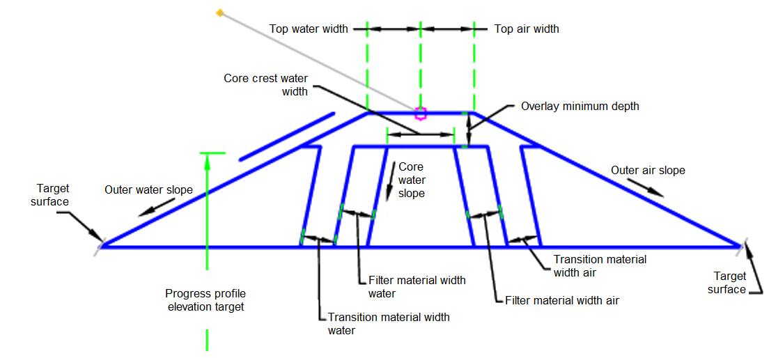

Dam
The Dam subassembly inserts links to create a representation of a dam. A progress profile is present to adjust the dam geometry to reflect the progress.
The attachment point is at the centre of the dam.
Input Parameters
Note: Note: All dimensions are in metres or feet unless otherwise noted. All slopes are in run-over-rise form (for example, 4 : 1) unless indicated as a percent slope with a “%” sign.
Parameter
Description
Type
Default
Outer Water Slope Outer slope of dam facing the impounded water Slope 2 ( : 1)
Outer Air Slope Outer slope facing away from impounded water Slope 2 ( : 1)
Core Water Slope Core slope of dam facing the impounded water Slope 0.2 ( : 1)
Core Air Slope Core slope facing away from impounded water Slope 0.2 ( : 1)
Core Crest Thickness Thickness of Core at top of dam Numeric, positive
1.5 ft
0.45 m
Core Crest Water Width Width measured from the control point to the side facing the water Numeric
2 ft
0.6 m
Core Crest Air Width Width measured from the control point to the side facing the air Numeric
4 ft
1.2 m
Transition Material Width Air Width of the transition material between the Rockfill and core facing opposite the impounded water Numeric, positive
2 ft
1.2 m
Transition Material Width Water Width of the transition material between the Rockfill and core facing the impounded water Numeric, positive
2 ft
1.2 m
Filter Material Width Water Width of Filter Material facing the impounded water Numeric, positive
2 ft
1.2 m
Filter Material Width Air Width of Filter Material facing opposite the impounded water Numeric, positive
2 ft
1.2 m
Liner Material Offset Distance the liner should be offset from the finish gradient to show in sections Numeric, positive
0.25 ft
0.1 m
Top Water Width Width of the top of the dam measured from the reference point to the water impoundment Numeric, positive
7.5 ft
2.2 m
Top Air Width Width of the top of the dam measured from the reference point opposite the water impoundment Numeric, positive
7.5 ft
2.2 m
Target Parameters
This section lists the parameters in this subassembly that can be mapped to one or more target objects. For more information, see To Specify Corridor Targets.
Parameter
Description
Status
Dam Daylight Surface Name of the daylighting surface. The following object types can be used as targets for specifying the surface: surfaces. Required
Progress Profile May be used to show progress of the dam based on the level of the level target. The following object types can be used as targets for specifying the level: profiles, 3D polylines, feature lines, or survey figures. Optional
Runtime Logical Assignments
None.
Output Parameters
None.
Behavior
The initial point is set at the attachment point. The outside daylight links are built. The interior structure of the dam is built based on the input parameters. The bottom surface of the dam is based on the Dam Daylight Surface.
If the progress profile is present then shapes are calculated based on the progress level. The level is applied as a level surface.
Layout Mode Operation
In layout mode, this subassembly displays the dam based on the input parameters given with a height of 20 ft (6 m).
Point, Link and Shape Codes
The following table lists the point, link and shape codes for this subassembly that have codes assigned to them. Point, link or shape codes for this subassembly that do not have codes assigned are not included in this table.
Point, Link or Shape
Code
Description
P1 TopCentre Top centre of the dam
P2 TopRight Top right of the dam
P3-P12 Dam Dam
P13 TopLeft Top left of the dam
L4-L10 Datum
S1 Rockfill
S2 TransitionMaterial
S3, S5 FilterMaterial
S4 Core
S6 Rockfill
Coding Diagram
