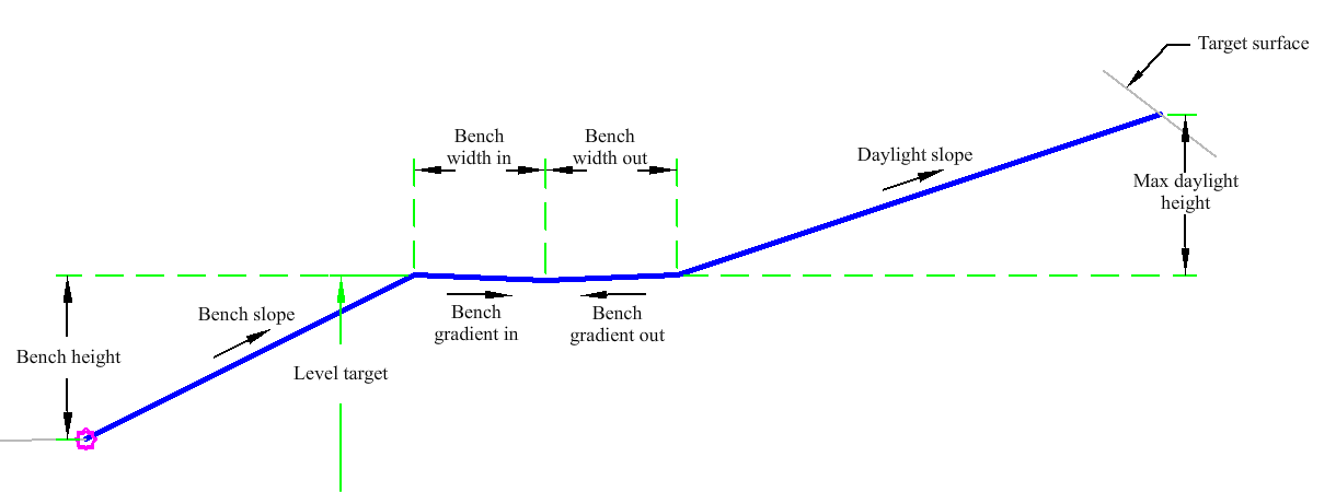

BasicBenchTargetElevations
The BasicBenchTargetElevations subassembly inserts links to create cut or fill catch slopes with repeating benches as needed.
You can define a swale width and depth at the benches as well as target a level at the bench point. This subassembly uses the looping functionality to repeat a specified number of times until a target level is found on a profile or a feature line and then finishes with a daylight link.
You specify a max daylight height and if the vertical distance between the insertion point and the target surface is higher than the specified max daylight height, then benching occurs using specified bench height, slope, gradient and width; this operation repeats itself until the target level is found.
If the target level is not found after the operation was repeated a specified number of times, the subassembly will finish using a daylight link until it reaches the target surface. If the vertical distance between the insertion point and the target surface is lower than the max daylight height, then there is no benching and a daylight link is placed.
If the target surface is not found after the operation was repeated a specified number of times, the subassembly will finish using a daylight link until it reaches the target surface.

The attachment point is at the inside edge of the initial cut or fill slope. This component can be attached to either the left or right side.

The initial hinge point is set at the attachment point. The hinge point level is checked against the target surface to determine if the section is in the cut or fill condition. An intercept is calculated to the target surface using the given Daylight Slope. If the height to the intercept exceeds the Max Daylight Height or the level target, the link with the Bench Height is inserted and the bench is added. The hinge point is reset to the outside edge of the bench and the process is repeated until a daylight link is found that does not exceed the Max Daylight Height.
This subassembly contains a loop definition comprised of L2, L3 and L4 that is repeated until it reaches the surface target or until it is repeated a maximum of 10 times.
