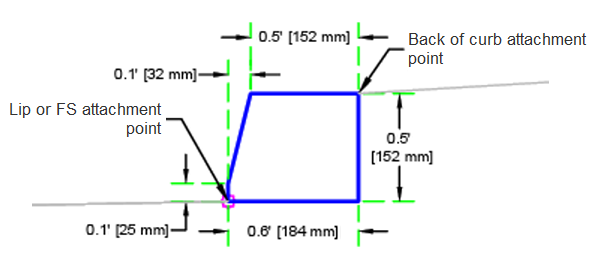

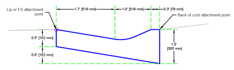

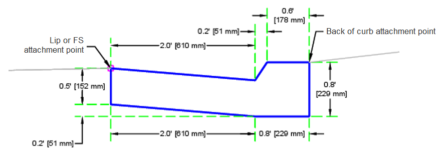

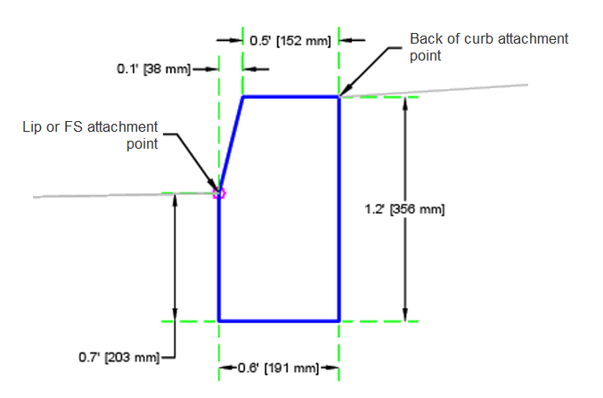

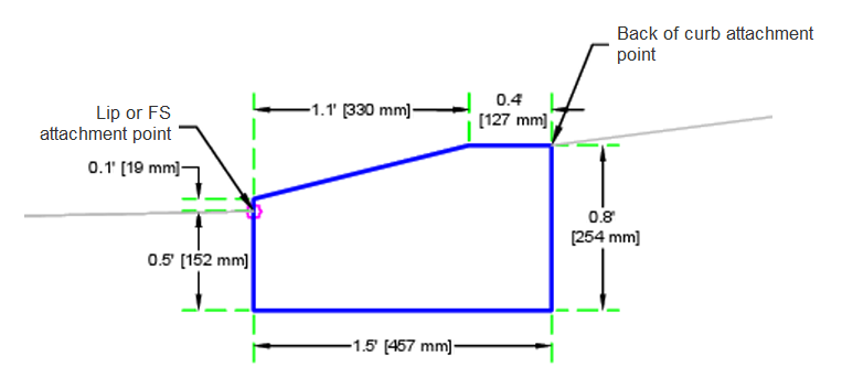

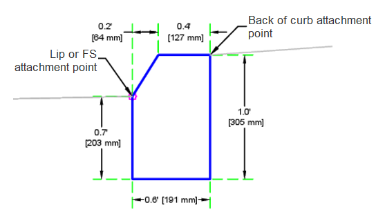

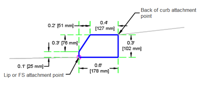

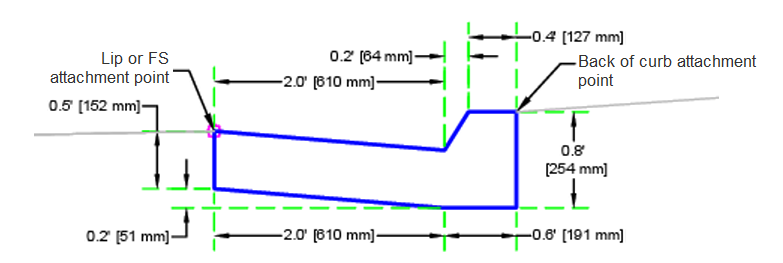

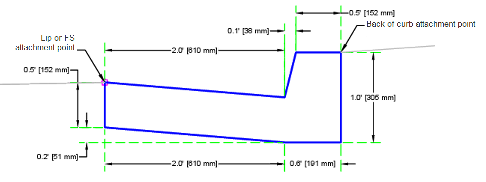

The CaltransCurbs subassembly inserts links to create kerbs and channels based on Caltrans Standard Plan RSP A87A.
You should verify that the dimensions used match your interpretation of the standard plan.
Caltrans Kerbs A1-6 and A1-8
Caltrans Kerbs A2-6 and A2-8
Caltrans Kerbs A3-6 and A3-8
Caltrans Kerbs B1-4 and B1-6
Caltrans Kerbs B2-4 and B2-6
Caltrans Kerbs B3-4 and B3-6
