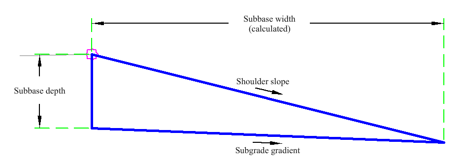

Behavior
The shoulder is inserted for the given shoulder depth, shoulder slope, and shoulder subgrade. The width is calculated where the shoulder slope and shoulder subgrade intersects. Then the points, links, and shapes are calculated.

S1 MaterialCode Material Code
Coding Diagram
