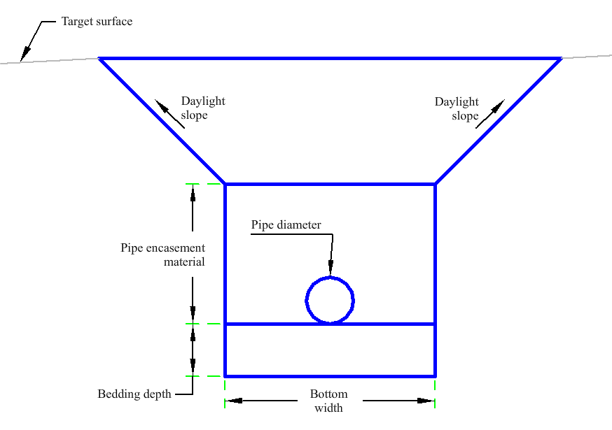

The PipeTrenchMultipleLayers subassembly has a single pipe in a trench and a layer of material encasing the pipe.
This subassembly allows volume calculation of bedding base, pipe zone and granular backfill. The pipe is encased in a layer of material right above the bedding. The center of the pipe will have a design profile. The depth will vary in the section of the granular backfill; the others will be a constant. All of the depths, widths, and diameters will change from trench to trench. The depth of the trench will vary along the alignment since it is measured from the bottom of the trench to the target surface.

Bottom Width Bottom width of the pipe trench. Numeric, positive
3 ft
1 m
Pipe Diameter Pipe diameter. Numeric, positive
0.667 ft
0.2 m
Bedding Depth Depth of the pipe bedding under the pipe invert. Numeric, positive
0.75 ft
0.2 m
Pipe Encasement Material Depth Depth of the pipe bedding over the pipe invert. Numeric, positive
2 ft
0.6 m
Target Surface Slope X : 1 slope of the trench sideslopes. Numeric, positive
1 (: 1)

The level of the bottom of the trench is calculated as the profile gradient line level minus half the pipe diameter plus the bedding depth. The horizontal trench bottom link is placed symmetrically about the attachment point offset at that level. The pipe encasement material depth is used to provide for the material around the pipe. The side slopes are extended upward to the existing surface. The horizontal bedding link is placed at the given depth above the trench bottom.
