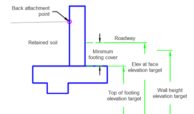

Case 1: Attachment point at back of retaining wall

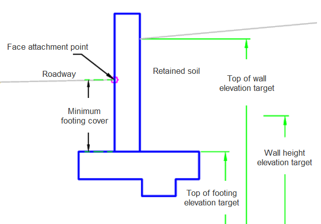

Case 2: Attachment point at face of wall
If the Elev at Face target is set the level is used. If the Elev at Face is not set then the Top of Footing plus the minimum footing cover is used. The top of footing target level is used to determine the physical height of the retaining wall. The footing builds using the standard plan dimensions based on the Wall Height Target.
The calculation for the top of wall is performed based on the Top Wall Target. The footing level is based on the Top of Footing Target. If the Top of Footing Target is not found then the Minimum Footing cover is used below the Attachment Point. The footing builds using the standard plan dimensions based on the Wall Height Target.
