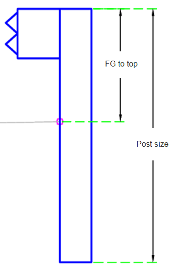

Behavior
The subassembly builds two rectangular shapes for the post and railing in addition to the rail shape. The post extends downward from the attachment point for a fixed distance below finish surface. The post extends upward the specified distance in the parameters.

P5 Grail_Face_Top Top guardrail face
P7 Grail_Face_Btm Bottom guardrail face
P10 Post_Top_In Inside top of the post
P11 Post_Top_Out Outside top of the post
P12 Post_Btm_Out Outside bottom of the post
P13 Post_Btm_In Inside bottom of the post
S1 Post Post
S2 Block Block
Coding Diagram
