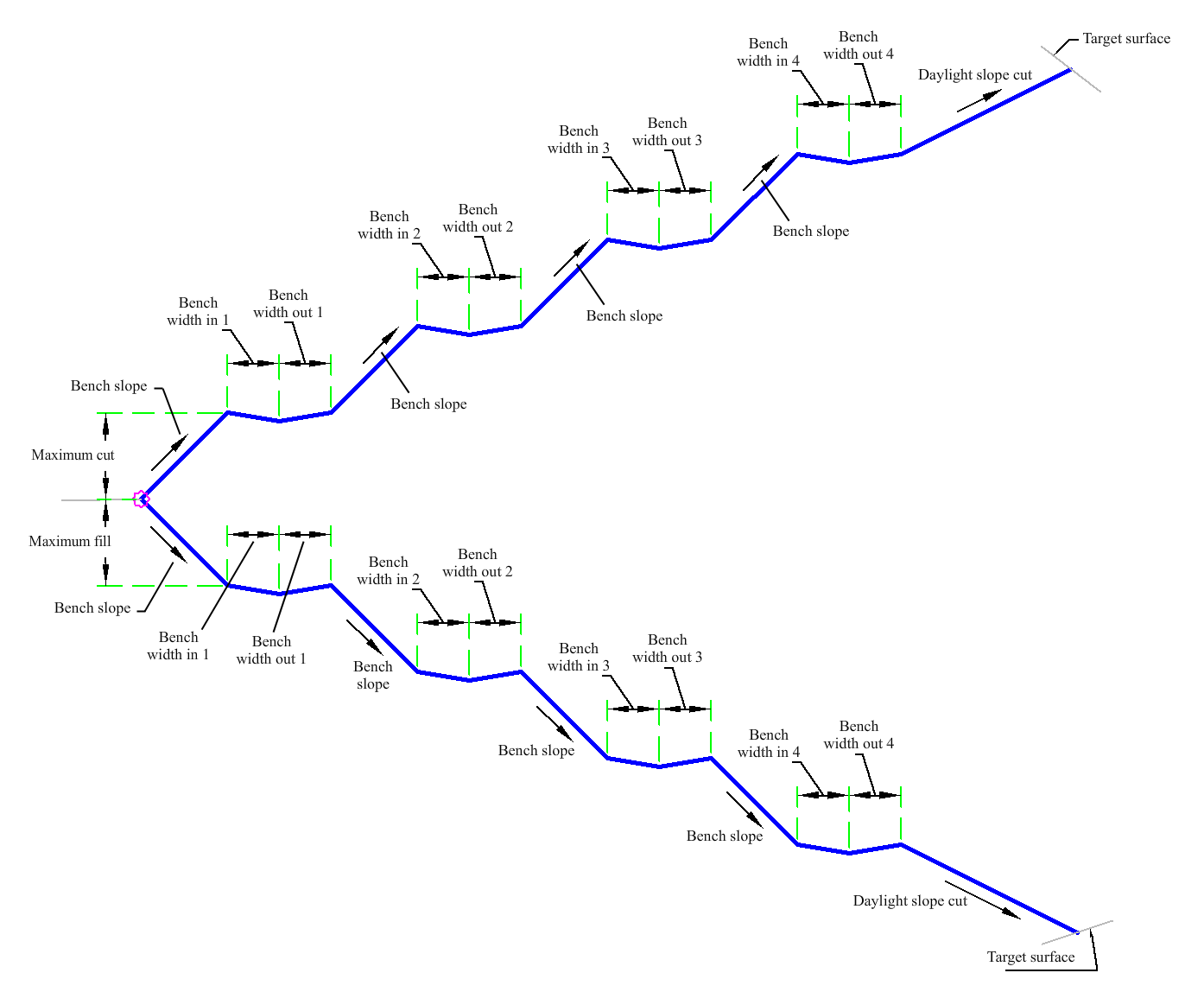

MultipleBench_Depth
The MultipleBench_Depth subassembly creates cut or fill catch slopes with benches with varying bench slopes, swale widths and swale depths.
You can define a swale width and depth at the benches. The last daylight slope to the target surface may be different than the bench slope.

Target Parameters
This section lists the parameters in this subassembly that can be mapped to one or more target objects. For more information, see To Specify Corridor Targets.
Parameter
Description
Status
Daylight Surface
Name of the daylighting surface. The following object types can be used as targets for specifying the surface: surfaces. Required
Runtime Logical Assignments
None.
Output Parameters
None.
Behavior
The initial hinge point is set at the attachment point. The hinge point level is checked against the target surface to determine if the section is in the cut or fill condition. An intercept is calculated to the target surface using the given Daylight Slope.
If the height to the intercept exceeds the Max Daylight Height, the link with the Bench Height is inserted and the bench is added. The hinge point is reset to the outside edge of the bench and the process is repeated until a daylight link is found that does not exceed the Max Daylight Height.
At each bench the entered input values are used to determine slopes and depths. After four benches the Daylight Slope Cut or Daylight Slope Fill is used to daylight and no more benches are added.

Point, Link and Shape Codes
The following table lists the point, link and shape codes for this subassembly that have codes assigned to them. Point, link, or shape codes for this subassembly that do not have codes assigned are not included in this table.
Point, Link, or Shape
Code
Description
P1 Hinge
P2, P5, P8, P11 Bench_In
P3, P6, P9, P12 Ditch
P4, P7, P10, P13 Bench_Out
P25 - P29 Daylight
L1, L4, L7, L10 Top, Datum, Bench
L2, L3, L5, L6, L8, L9, L11, L12 Top, Datum, Swale
L24 - L28 Top, Datum, Daylight
Coding Diagram
