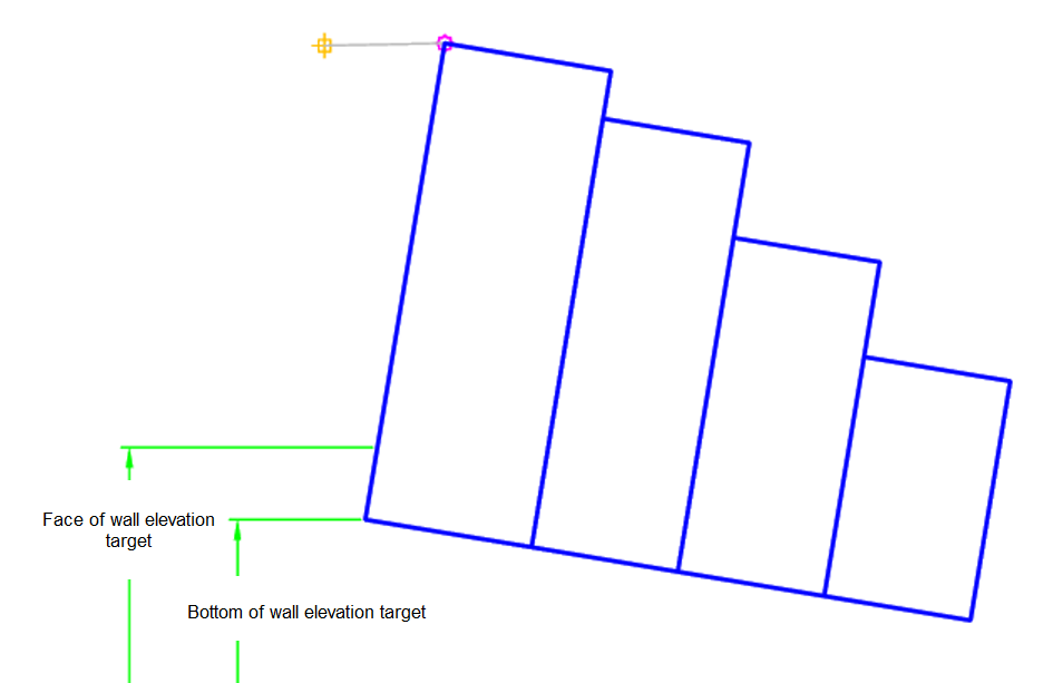

Case: Face of Wall

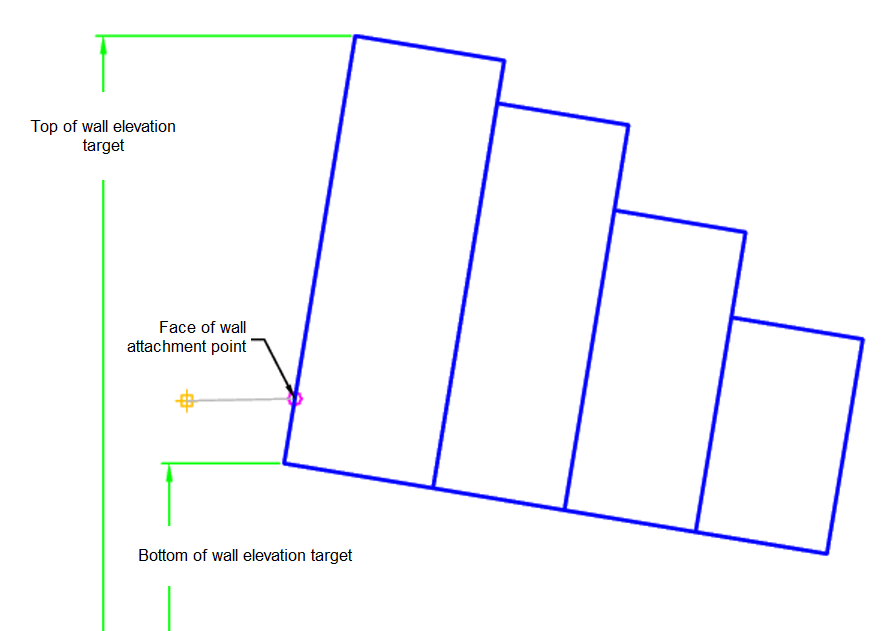

Case: Top of Wall

The attachment point is at the inside edge of the initial cut or fill slope. This component can be attached to either the left or right side.

Attach Point Attach point Top of Wall / Face of Wall Face of Wall

Bottom of Wall May be used to set the bottom of wall level. The following object types can be used as targets for specifying the level: profiles, 3D polylines, feature lines or survey figures. Optional
Face of Wall May be used to set the face of wall level point. The following object types can be used as targets for specifying the level: profiles, 3D polylines, feature lines or survey figures. Optional (Attachment Point = Top of Wall)
Top of Wall May be used to set the top of wall level. The following object types can be used as targets for specifying the level: profiles, 3D polylines, feature lines or survey figures. Optional (Attachment Point = Face of Wall)
