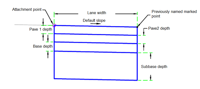

LaneWithMarkedPoint
The LaneWithMarkedPoint subassembly creates a cross-sectional representation of a travel lane, with a way to connect a link from the attachment point to a previously named marked point.
This subassembly can be used in a variety of situations, including connecting between adjacent carriageways where the relative offsets and levels vary, or across a gore area between converging carriageways. Use the MarkPoint subassembly if the connecting point has not already been named.
The attachment point is at the beginning of the lane. The link may go in any direction. The direction is determined by the location of the marked point relative to the attachment point. Be sure to name the marked point and set the marked point name in this subassembly. The Marked Point name must be in all UPPER CASE letters.

Behavior
The marked point is found and the lane width and lane slope are calculated based on the marked point location. If the marked point is not found, the entered lane width and lane slope from the user input values are used.
Starting at the attachment point, a finish gradient surface and parallel subgrade are inserted using the given width, depth and the found or entered slope. Vertical links close the shape at either end of the lane.
Layout Mode Operation
In layout mode, this subassembly displays all lane links using the width and depth input parameters.
