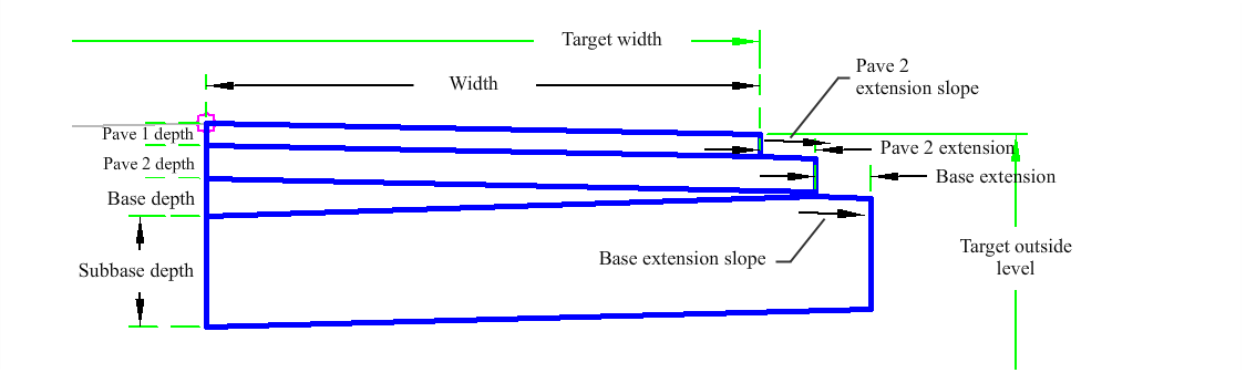

ShoulderVariesExtensions
The ShoulderVariesExtensions subassembly has a base and subbase that extends past the rest of the pavement layers.
The attachment point is at the inside edge of the paved shoulder, which is typically at the outside edge of carriageway.

The finish surface of the shoulder is inserted for the given Shoulder Width and Default Shoulder Slope outward from the attachment point. The Pave2 points and links are then drawn. A Pave2 extension is provided using the input parameters. The Base points and links, including extension, are calculated using the input parameters. The Subbase points, links, and shape, including extension, are calculated using the input parameters.
Layout Mode Operation
In layout mode the subassembly displays the links comprising the shoulder.
Point, Link, and Shape Codes
The following table lists the point, link, and shape codes for this subassembly that have codes assigned to them. Point, link, or shape codes for this subassembly that do not have codes assigned are not included in this table.
Point, Link, or Shape
Code
Description
P1 Top, Hinge
P4 Daylight, Top
L1 - L3 Top
S1 Pave1
S2 Pave2
S3 Base
S4 Subbase
Coding Diagram
