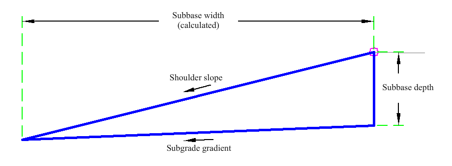

Behavior
The shoulder is inserted for the given shoulder depth, shoulder slope, and shoulder subgrade. The width is calculated where the shoulder slope and shoulder subgrade intersects. Then the points, links, and shapes are calculated.
Layout Mode Operation
In layout mode the subassembly displays the links comprising the shoulder.
Point, Link, and Shape Codes

Coding Diagram
