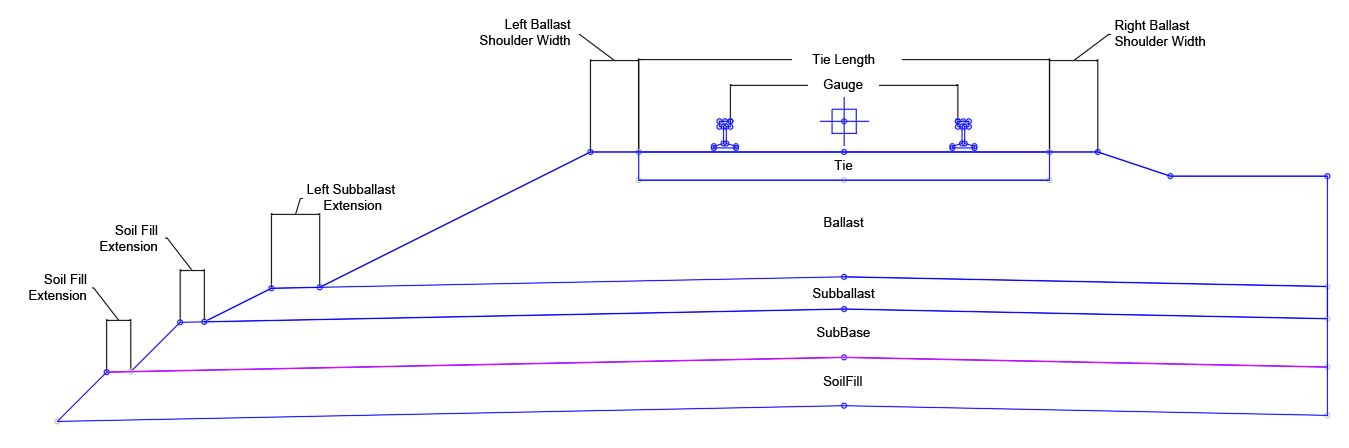

The Left_Hand_Multi_Track subassembly is used for a single railroad that includes sleepers, ballast, subballast and two additional layers or materials which can be used for Sub Base and Soil Fill material.
The dimensions of the Left_Hand_Multi_Track rails can be edited as well as the dimensions of the material layers.

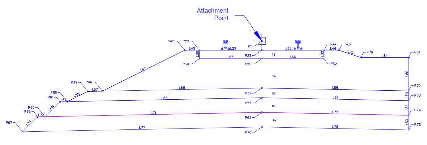

By default, the attachment point is at the centreline between the rails. The track can be moved relative to this point using the subassembly parameters.

Ballast Shoulder Width (Left and Right) The distance from the end of the tie to the beginning of the ballast side slope. Numeric, non-negative 12"
305 mm
Ballast Side Slope (Left and Right) The slope of the sides of the ballast material. The slope of the top of the ballast material matches the slope of the tie that results from cant. Slope, non-negative 2:1

Point, Link and Shape Codes
The following table lists the point, link and shape codes for this subassembly that have codes assigned to them. Point, link, or shape codes for this subassembly that do not have codes assigned are not included in this table.
Point, Link, or Shape
Code
Description
P1, P4-P21 Rail Rail
P2 Cl_Rail Centreline of Rail
P3 Gauge_Line, Rail Gauge line (inside edge of top of rail)
P28-P32, P60 Tie Tie
P45, P54-P55, P47, P71-P72 Ballast Ballast
P50, P53, P73 Subballast Subballast
P63, P65, P74 SubBase SubBase
P68-P70, P75 SoilFill SoilFill
L1, L2 Top_Rail, Rail Top of rail
L3-L28 Rail Rail
L29-L33, L65-66 Tie Tie
L40-L41, L44, L55-L56, L79, L88 Ballast Ballast
L57, L60-L62, L80 Subballast Subballast
L70-L72, L81 SubBase SubBase
L76-L78, L82 SoilFill SoilFill
S1, S2 Rail Rails
S3 Tie Tie
S4 Ballast Ballast
S5 Subballast Subballast
S6 SubBase SubBase
S7 SoilFill SoilFill
